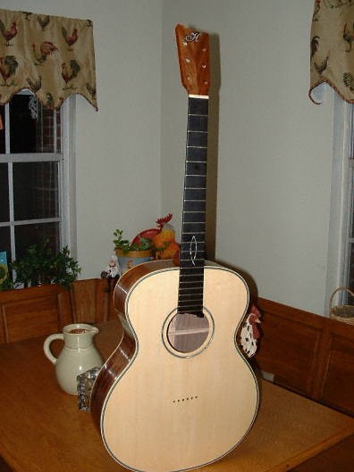

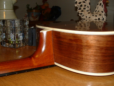

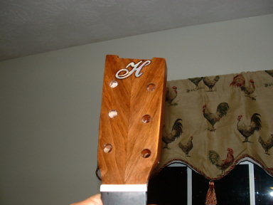

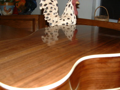

PostPosted: Tue Mar 27, 2007 3:13 pm
I know this guitar is nothing special, but just wanted to see if the shine of the french polishing job I have have completed will show up in pictures.
Here is the latest
PostPosted: Tue Mar 27, 2007 3:19 pm
By the way, this is a walnut back and side and italian spruce top guitar with a mahogany neck. Abalone rosette and herringbone purfling. that is a fish inlaid in the fingerboard.
PostPosted: Tue Mar 27, 2007 4:59 pm
Hey, Ken, that looks mighty nice! And it passes the critical "read the poultry" test with flying (snicker!) colors!
